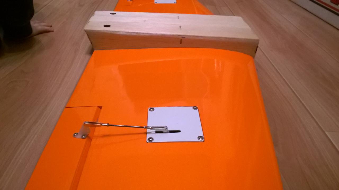

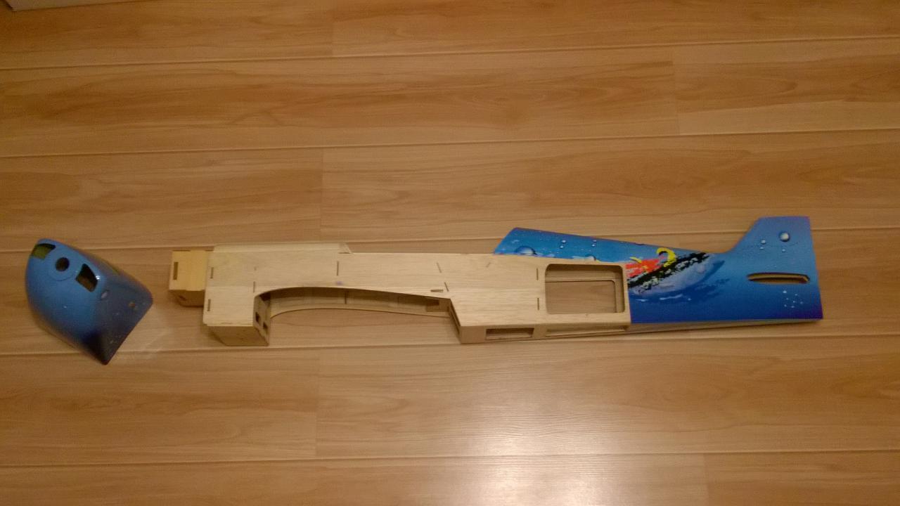

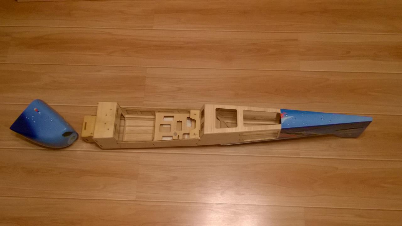

    Няколко кадъра досега...
ID:	7049   Click image for larger version
ID:	7050   Click image for larger version
ID:	7051   Click image for larger version
ID:	7052   Click image for larger version
ID:	7054   Click image for larger version
    Стоян Пулевски '71 набор.
