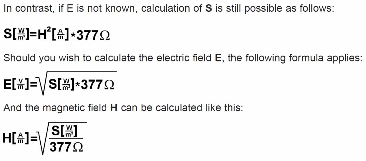

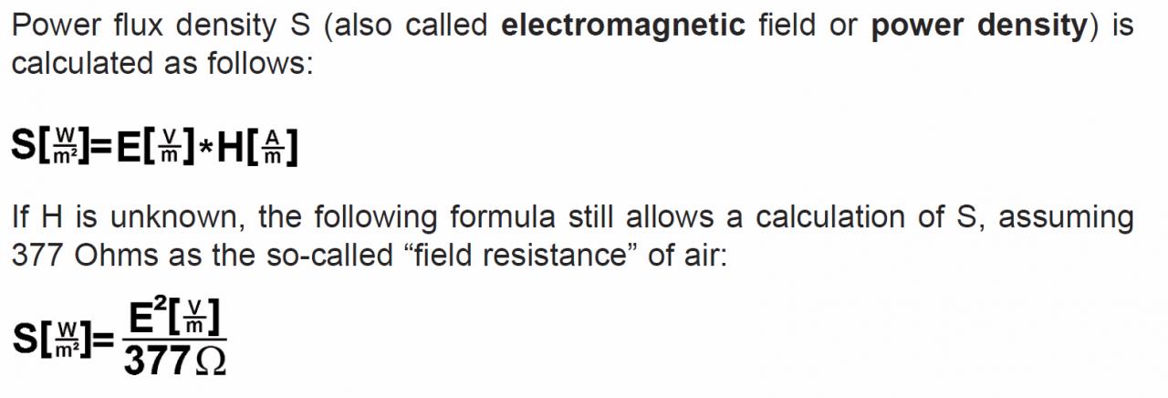

    However, the most frequently used unit is V/m (see table 2 on page 64). Here you should remember that power flux density S (measured in W/m²) really consists of two separate fields: The electric field E (measured in V/m) and the magnetic field H (measured in A/m). However, as these do not exist separately anymore at high frequencies, their separate indication is not really interesting for RF exposure.
    А ето и формулите. Публикувам ги като картинки, защото няма как да копирам самите формули:
